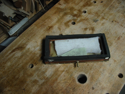

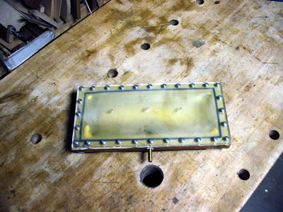

John, here's a couple of picts of the one I made several years ago.
Latex rubber for the membrane. - McMaster Carr
Acrylic for membrane protection. - McMaster Carr
0-ring cord stock for the membrane to wood seal. - McMaster Carr
Caulking for support of the membrane in the corners.
Closed cell faom rubber for the seal against the top. - McMaster Carr.
The white stuff on the inside is a type of non-woven that ensures that the vacuum pressure is evenly distributed over the bridge area. without it you could choke off the vacuum in some areas by the membrane. Most any fabric would work. I suspect most forgo the fabric however.
